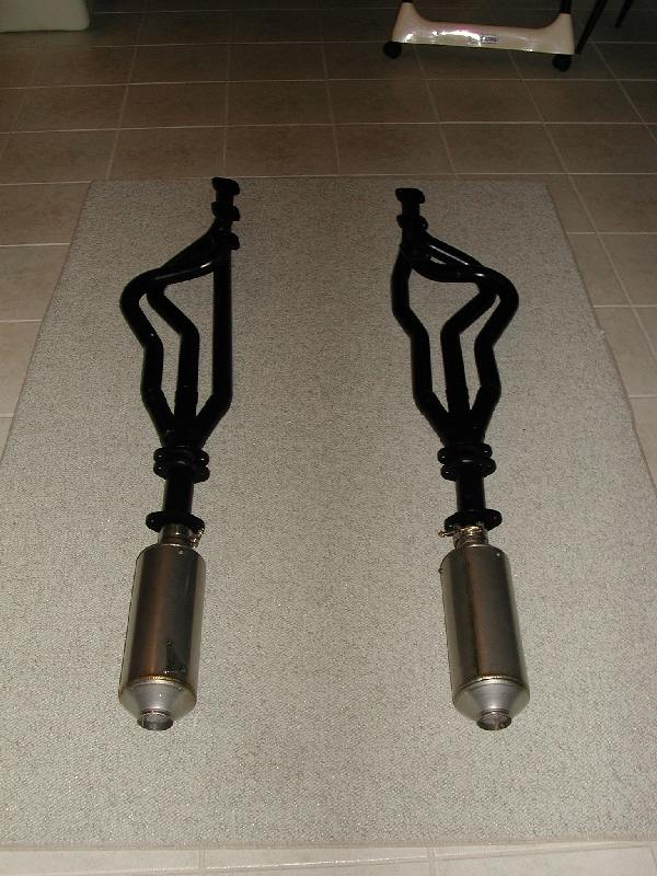

Hmmm... I think I'm gonna like this exhaust setup...

Qarl   European Racing Headers came in today... They look...   Jul 31 2003, 07:29 PM
Qarl   Hmmm... I think I'm gonna like this exhaust se...   Jul 31 2003, 07:30 PM
Scott Carlberg   Karl, what type of mufflers are those in the las...   Jul 31 2003, 11:07 PM
Qarl   Mufflers.... click here... http://www.914world.co...   Jul 31 2003, 11:10 PM
