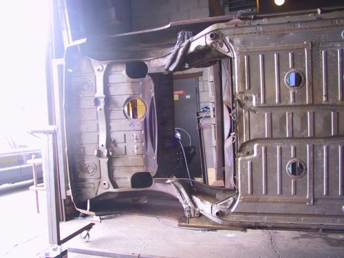

That was the top, from the rear, obviously. Now the rear half, from the bottom:

michel richard   CO2 blasting is done. Here are pics of the tub on...   Aug 29 2005, 06:01 PM
michel richard   That was the top, from the rear, obviously. Now t...   Aug 29 2005, 06:02 PM
michel richard   And the front half, from the bottom:   Aug 29 2005, 06:03 PM
michel richard   The good news is that the floor pans under the pas...   Aug 29 2005, 06:14 PM
