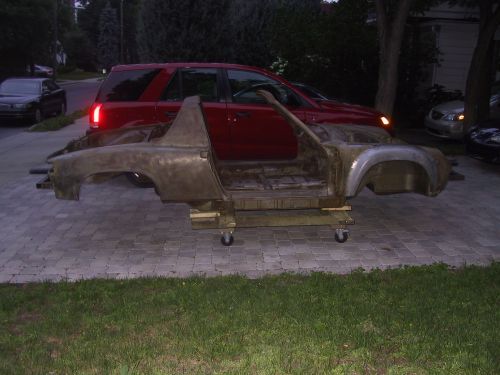

The tub is back home. This is the rig that I threw together to make it possible to have the car towed. It turns out that the bodyman had not gotten around to shooting the car with primer when I showed up today, to take the car back.
So the plan is now to fix the front trunk as well as I can and then to use POR 15 to prepare the tub. That will mean super-thorough cleaning, etching, then the paint. At least it's something I've done in the past, so I should be OK.
