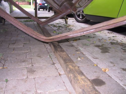

Before I put the tub back up on the rotisserie, I shortened the latter, a little bit. The center of the swing axis is now 35.5 inches above the top of the longitudinal bar.
Unfortunately that's a little bit short. The corner of the windshield frame fouls the bar:
