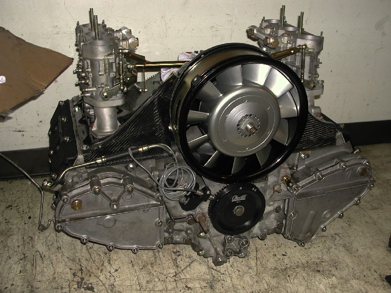

Engine is 99% done... just need some pulley parts and the carb jetting pieces...

Qarl   European Racing Headers came in today... They look...   Jul 31 2003, 07:29 PM
Qarl   Hmmm... I think I'm gonna like this exhaust se...   Jul 31 2003, 07:30 PM
Scott Carlberg   Karl, what type of mufflers are those in the las...   Jul 31 2003, 11:07 PM
Qarl   Mufflers.... click here... http://www.914world.co...   Jul 31 2003, 11:10 PM

Qarl   Engine Dressing...   Aug 2 2003, 01:57 PM
URY914   Paul, Is this going to be a work of art or a car? ...   Aug 2 2003, 06:09 PM
Curvie Roadlover   You're gonna need some velvet ropes to put aro...   Aug 2 2003, 08:43 PM
Qarl   Engine is 99% done... just need some pulley parts ...   Aug 8 2003, 05:31 PM
