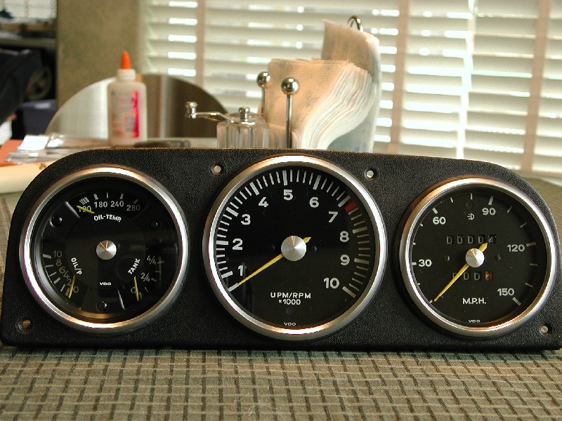

Shriveled member ![]() ![]() ![]() ![]() ![]() Group: Benefactors Posts: 5,233 Joined: 8-February 03 From: Florida Member No.: 271 Region Association: None |
Gauges are done...

Where did you get the bezels for your gauges... Aug 8 2003, 07:57 PM
Qarl Palo Alto Speedometer installed them...
http://ww... Aug 8 2003, 09:03 PM
