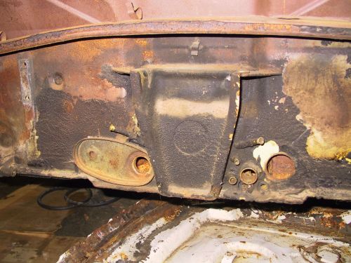

Here is how the lower engine compartment loolked like when I got he car:
