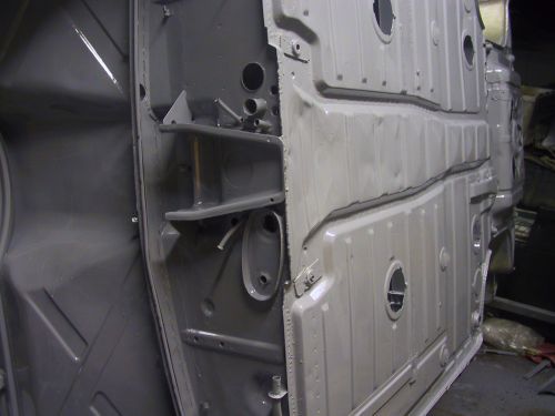

michel richard   Quite a bit of progress made since th last update....   Oct 2 2005, 06:49 PM
michel richard   The same area just before paint (POR - 15, actuall...   Oct 2 2005, 06:50 PM
michel richard   And after the POR -15   Oct 2 2005, 06:51 PM
michel richard   I added a sub-thread with a bunch of pictures of t...   Oct 2 2005, 06:53 PM
