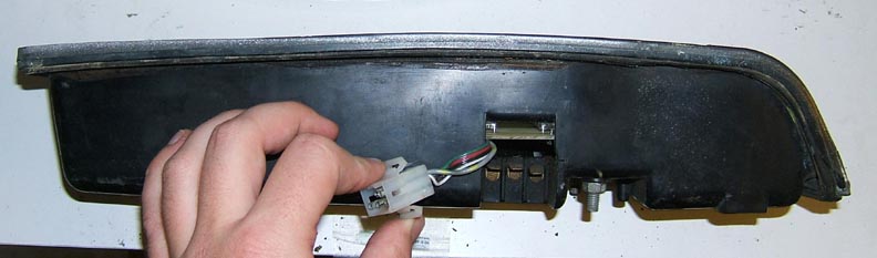

Pic 5
This is a detail shot of the major housing modification that you have to do.

smrz914   Pic 5 This is a detail shot of the major housing m...   Oct 2 2005, 10:57 PM
smrz914   And another shot of the same mod   Oct 2 2005, 10:58 PM
