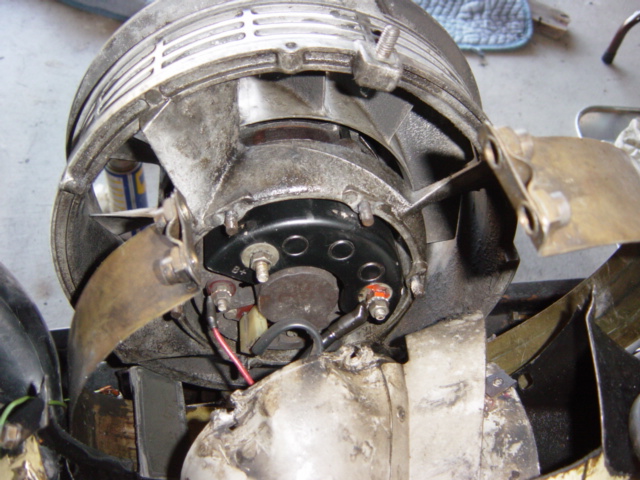

I have a problem where I get a major spark when attaching the battery cables to the battery. Clay Perrine pointed out to me that it's the heavy RED wire that's attached to the Starter (same place as the battery cable) and runs up to the back of the alternator. Clay suggested that this red wire was hooked to the wrong post on the altenator. OK, I removed the complete CIS injection unit and peeled back the engine shoud. The wires were hooked up to the alternator like in Wayne Dempsy's book, the pictures I took upon disassembly were lost so I had to use the book for this. I'm using a newly rebuilt Marchall alt. with external regulator. Here's a breakdown of how I have it wired:
(posts are clockwise from the top)
"+G1" or "+61" = blue wire
"B+" = Red wires [one thick, one thinner]
"another B+" = short ground strap from engine case
"DF" = black wire with spade end
"D-" = 3 small brown wires
"D." = un-used
Where have I gone wrong?
Doug C

Here is a photo of my alt.
Jeff
PS: this is from a factory 6 not a late model transplant

Jeffs9146   Here is a photo of my alt. Jeff PS: this is from...   Oct 3 2005, 01:00 PM

DougC   Thanks for the picture Jeff. Unfortunately for me,...   Oct 3 2005, 01:10 PM
Jeffs9146     Oct 3 2005, 01:13 PM
DougC   Jeff, from looking at the picture it seems to have...   Oct 3 2005, 01:25 PM

DougC   OK guys, I had the ground strap connected wrong. I...   Oct 5 2005, 09:47 AM
