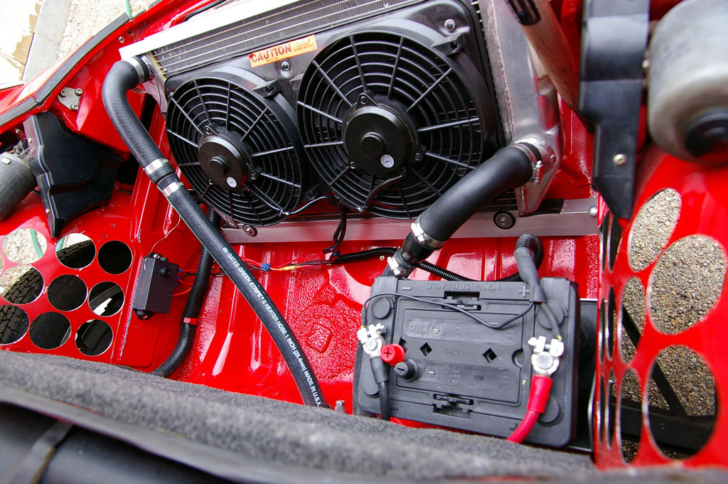

dbledsoe   Radiator and fans installed, although I still have...   Oct 4 2005, 09:36 AM
dbledsoe   another   Oct 4 2005, 09:37 AM
dbledsoe   another oops!   Oct 4 2005, 09:37 AM
dbledsoe   another   Oct 4 2005, 09:42 AM
jimkelly   I wonder what percentage of air is gonna be able t...   Oct 4 2005, 09:45 AM
dbledsoe   <...   Oct 4 2005, 09:49 AM
914GT   Nice clean radiator install Don. I was thinking of...   Oct 4 2005, 09:50 AM
