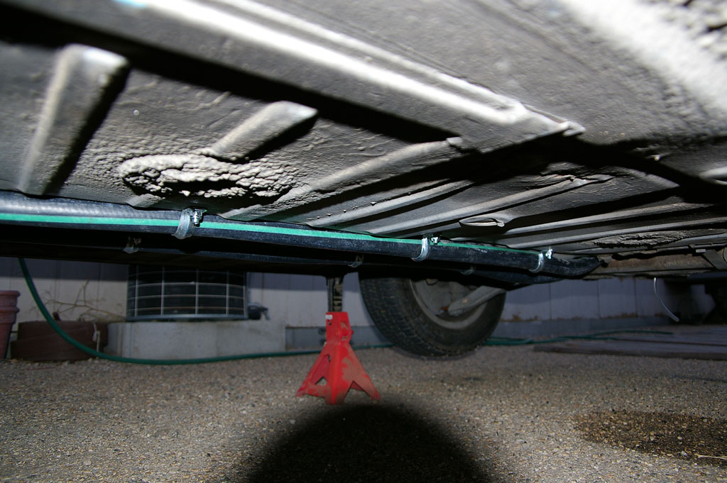

dbledsoe   lines beneath the car   Oct 4 2005, 09:56 AM
dbledsoe   Another beneath   Oct 4 2005, 09:56 AM
