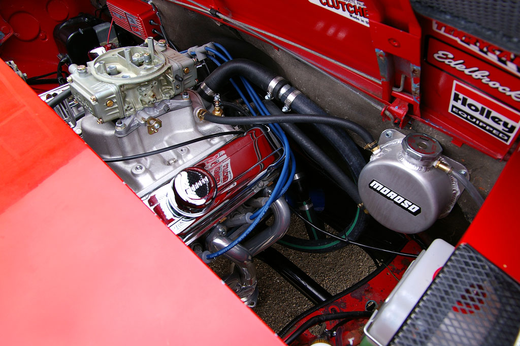

Expansion/fill tank

dbledsoe   Expansion/fill tank   Oct 4 2005, 09:58 AM
