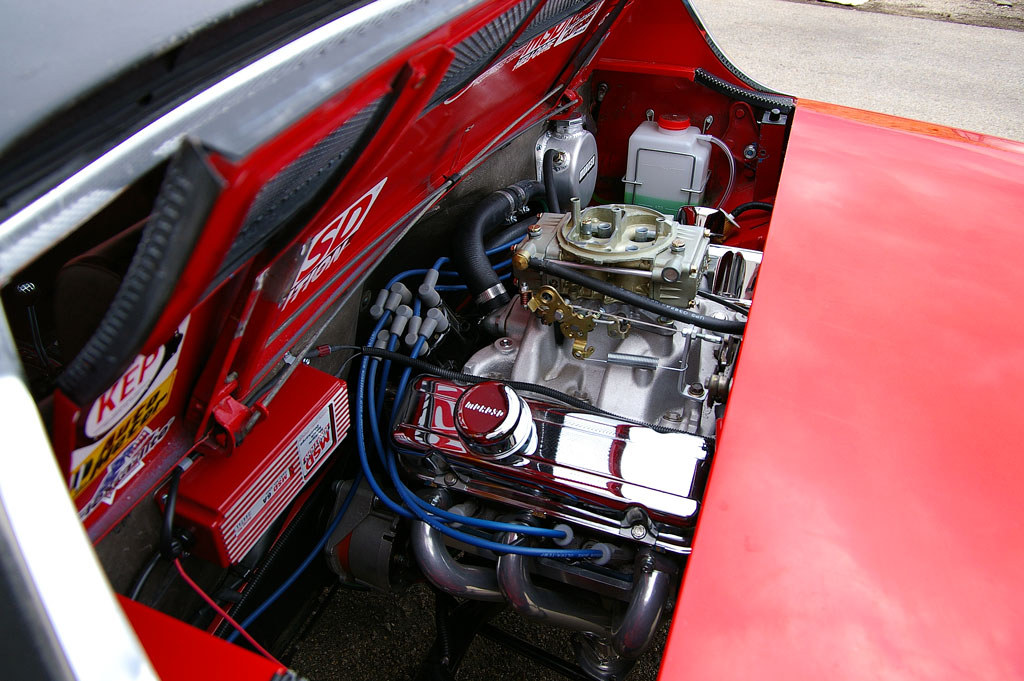

Got the engine & transaxle into the car, bolted up at the back, and ready to fabricate a few minor parts to make the new forward crossmember mate to the body. The forward crossmember was bought from Speedway Motors in Lincoln Nebraska for a grand total of $58 to my door (http://www.speedwaymotors.com/). The crossmember clears the shift linkage just fine. (IMG:http://www.914world.com/bbs2/html/emoticons/mueba.gif)

QUOTE (914GT @ Oct 4 2005, 09:50 AM)
Nice clean radiator install Don. I was thinking of trying punching the holes out in the wheelwells too but opted for the easy way. Probably plenty of airflow for a V6. Are you going to shroud the radiator or do you think it will be necessary? Does that radiator cap overflow go off to a tank somewhere so it doesn't suck in air when cooling? Again, very nice job.
Thank you Guy! After reading your conversions I consider that a real compliment!
The front radiator cap is a 25psi cap. The overflow shouldn't be needed but I added one anyway. It now vents beneath the car. The expansion/fill tank has a 16psi cap and vents to an overflow tank in the engine bay.

dbledsoe   I mounted the coil to the old heater blower mount ...   Oct 4 2005, 10:05 AM
dbledsoe   A tad short on carb to engine lid clearance thanks...   Oct 4 2005, 10:07 AM
dbledsoe   I can close the engine lid but I had to cut out th...   Oct 4 2005, 10:10 AM
