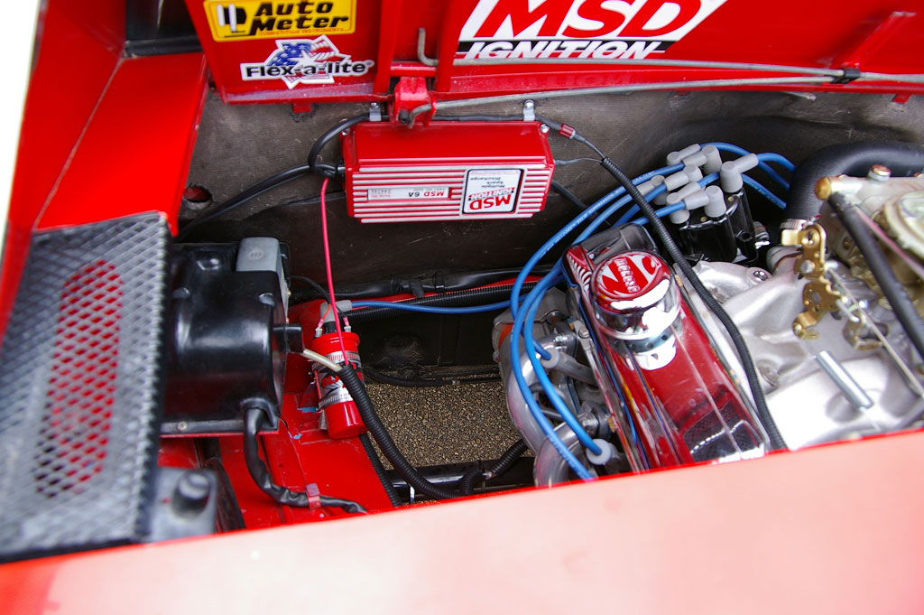

Got the engine & transaxle into the car, bolted up at the back, and ready to fabricate a few minor parts to make the new forward crossmember mate to the body. The forward crossmember was bought from Speedway Motors in Lincoln Nebraska for a grand total of $58 to my door (http://www.speedwaymotors.com/). The crossmember clears the shift linkage just fine. (IMG:http://www.914world.com/bbs2/html/emoticons/mueba.gif)

I mounted the coil to the old heater blower mount base with a couple of hose clamps. That seemed like a nice location since the Buick V6 has a front mounted distributor.

dbledsoe   OK!!! We have ignition. http://www.914world.com/bbs2/...   Oct 1 2005, 08:47 PM
