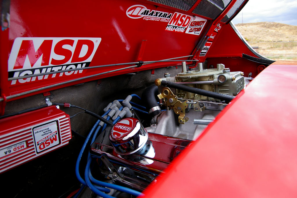

A tad short on carb to engine lid clearance thanks to the Edelbrock dual plane "Performer" intake manifold.

ClayPerrine   That is one funny looking carburetor!!   Jul 5 2005, 11:10 AM

dbledsoe   I can close the engine lid but I had to cut out th...   Oct 4 2005, 10:10 AM
