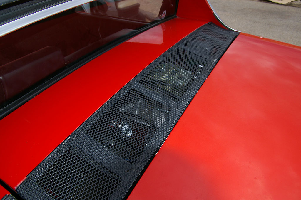

dbledsoe   A tad short on carb to engine lid clearance thanks...   Oct 4 2005, 10:07 AM

914GT   Thanks for the air cleaner info. Here's how I ...   Oct 4 2005, 11:07 AM

914GT   Don, I made the intake opening on the red 76 the ...   Oct 4 2005, 09:35 PM
