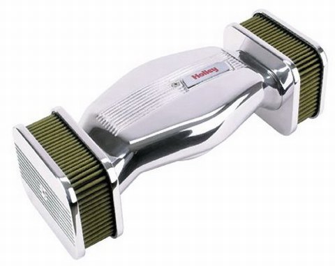

QUOTE (914GT @ Oct 4 2005, 10:41 AM)
Don, good idea on the front radiator cap with the higher pressure. And you have an easy way to bleed the radiator when filling the system. How much flex resulted from cutting out the engine lid brace? I'm considering that for my yellow car to get more air cleaner options. I was looking at the K&Ns and also a low profile oval billet cleaner. I'll still avoid cutting it if I can. I lost 1/2" by using a carb. spacer. I needed the spacer because my carb was getting too hot in +105 deg temps and stuck in traffic.
I'd like to see a view of your front bumper and the intake opening.
Guy,
It defintely flexs but not as bad as I thought it might. I can still close the lid from either side and it closes all the way down on the bumpers/stops/rubber thingies just fine fine from either side of the car.
The K&N plenums are ridiculously over priced but it seemed to be about my only option, and not that great of one at that. Cutting the cross brace defintely provides more room. There is a ver low profile air cleaner that uses two filter elements, one off to each side (see picture below) available from Speedway Motors
http://www.speedwaymotors.com/SearchResult...rd=air+cleaners
but it sells for $229 and shipping. I've seen one on a 914 SB Chevy conversion here locally.
(IMG:http://www.914world.com/bbs2/html/emoticons/agree.gif) about avoiding cutting. I'm still looking for other options. Cutting will be the last thing I do.
The front bumper is still as delivered from GT Racing. I haven't cut the hole in it yet. That's my next step in this project after I get the Auto Meter gauges in (tomorrow night hopefully) and the interior put back together. I'll post photos here once I get the bumper installed.

dbledsoe   Here's a picture from the Speedway Motors web ...   Jul 5 2005, 04:23 PM
