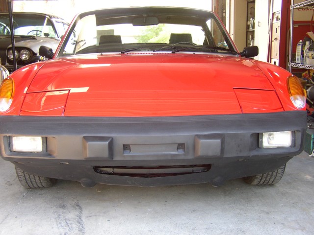

Thanks for the air cleaner info. Here's how I modified the stock 76 bumper. From usual standing height the opening is hardly noticeable so retains nearly original look. So far seems to be enough airflow (it can pull from the bottom front of the trunk too). Look forward to seeing your new bumper mounted in place.
