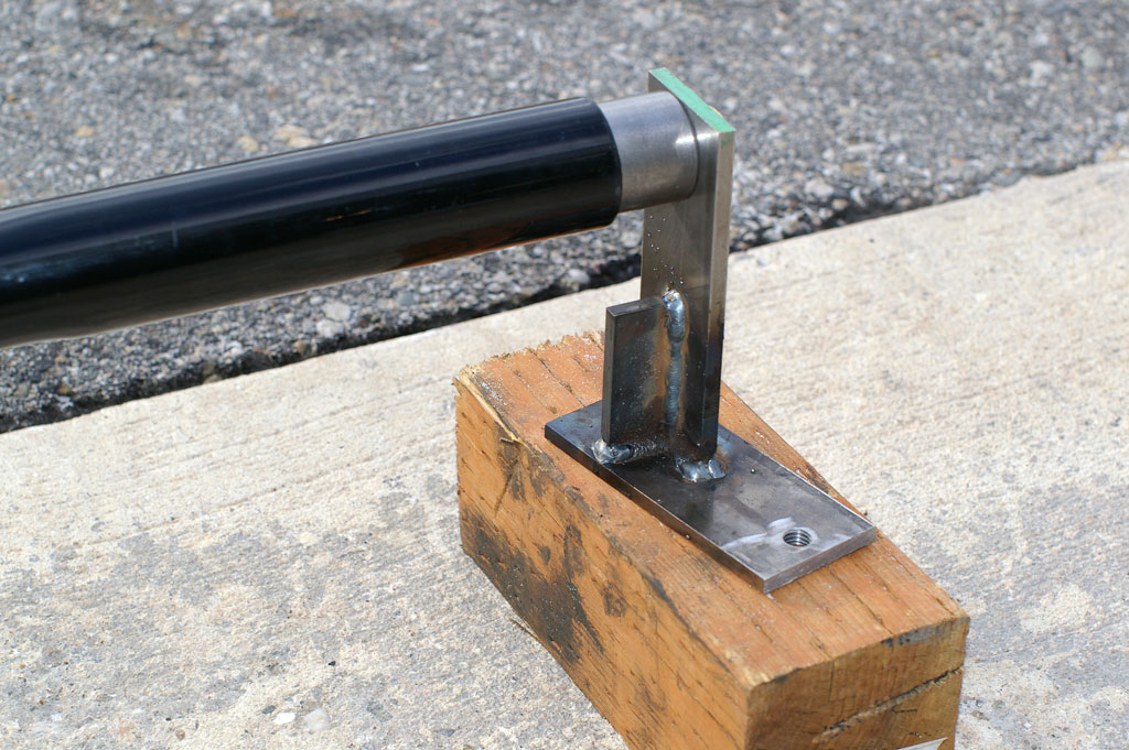

QUOTE (pjhaun @ Oct 5 2005, 12:09 AM)
Don:
I forgot to ask you, What kind/type alternator bracket did you use? Do you happen to have pictures of the front of the engine with the belts and brackets in place?
Thank You!!!!!
Phillip J. Haun
Oak Harbor, WA.
Phillip,
below is a close up of one end of the mount I made and the photo below that is the same end of the mount as installed in the 914. I hope they give you a better idea of how I mounted my engine. The circled item in the upper left corner of the second photo below is the 1/4" quick release pin that keeps the mount from moving side to side when bolted in place in the car.
