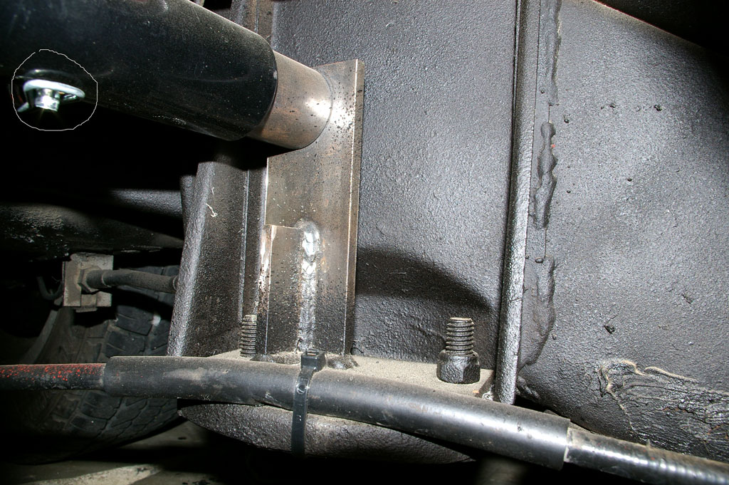

Got the engine & transaxle into the car, bolted up at the back, and ready to fabricate a few minor parts to make the new forward crossmember mate to the body. The forward crossmember was bought from Speedway Motors in Lincoln Nebraska for a grand total of $58 to my door (http://www.speedwaymotors.com/). The crossmember clears the shift linkage just fine. (IMG:http://www.914world.com/bbs2/html/emoticons/mueba.gif)

dbledsoe   I finally got around to completing the forward mot...   Jul 22 2005, 10:33 AM
dbledsoe   Close up of end piece.   Jul 22 2005, 10:34 AM
