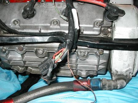

Went through my old pics (this was my old motor) and found a pic of the harness and the big red wire with taped end and the brown and black wire I think Doug is having trouble with. Can anyone tell from this pic what those two wires are too?
TIA
Ferg
