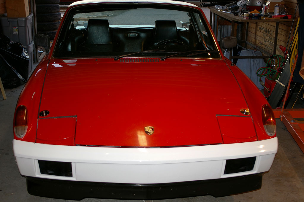

Got the engine & transaxle into the car, bolted up at the back, and ready to fabricate a few minor parts to make the new forward crossmember mate to the body. The forward crossmember was bought from Speedway Motors in Lincoln Nebraska for a grand total of $58 to my door (http://www.speedwaymotors.com/). The crossmember clears the shift linkage just fine. (IMG:http://www.914world.com/bbs2/html/emoticons/mueba.gif)

dbledsoe   I finally got around to completing the forward mot...   Jul 22 2005, 10:33 AM
dbledsoe   Close up of end piece.   Jul 22 2005, 10:34 AM

dbledsoe   Radiator and fans installed, although I still have...   Oct 4 2005, 09:36 AM
dbledsoe   another   Oct 4 2005, 09:37 AM
dbledsoe   another oops!   Oct 4 2005, 09:37 AM
dbledsoe   a real another Still some clean up work to do on ...   Oct 4 2005, 09:40 AM
dbledsoe   another   Oct 4 2005, 09:42 AM

dbledsoe   I mounted the coil to the old heater blower mount ...   Oct 4 2005, 10:05 AM
dbledsoe   A tad short on carb to engine lid clearance thanks...   Oct 4 2005, 10:07 AM
dbledsoe   I can close the engine lid but I had to cut out th...   Oct 4 2005, 10:10 AM
