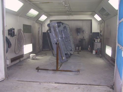

had the tub towed to a bodyshop not far from my house. The plan is to have the interior and the underside painted, so that I can start assembling. Final paint of the exterior body will be done when the bodyman has more time, over the winter.
The tub was towed on the rotisserie, on a flatbed. Glad we did'nt go too far. I'll make sure I get a picture when the truck returns on Monday.
The painter is very friendly and he called me over to his shop around noon today (Saturday) to make sure the color is right, It's Conda green. I can now say it will be visible from quite a distance ! It's a very bright color.
Here's the car in the paintbooth, on October 15, 2005.
Cheers.
Michel
