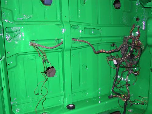

All excited, and I started putting the wring through. First thing is to feed the trunk that goes to the rear of the car through the center tunnel, from the very front of the tunnel.
Here I'm feeding it. You don't see my kind daughter on the other side, gently pulling. We put a messenger on the multi-wire plug that goe to the relay board, and that helped a lot.

michel richard   All excited, and I started putting the wring throu...   Oct 17 2005, 07:12 PM
michel richard   Main trunk to the rear in place. Time to go watch...   Oct 17 2005, 07:13 PM
