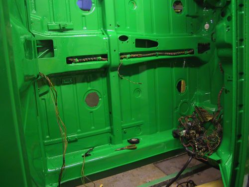

michel richard   All excited, and I started putting the wring throu...   Oct 17 2005, 07:12 PM
michel richard   Main trunk to the rear in place. Time to go watch...   Oct 17 2005, 07:13 PM

michel richard   Made a bit of progress on the wiring: I installed...   Oct 19 2005, 07:20 PM
michel richard   Oh, and I realized that I fed the wiring bundle th...   Oct 19 2005, 07:22 PM
