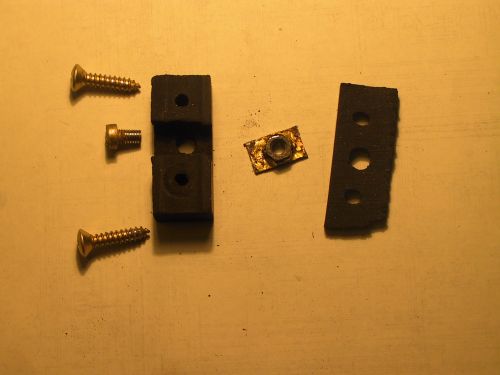

I started a separate thread to find help figuring out what was what with the red wires and got these very good responses:
http://www.914world.com/bbs2/index.php?act=...f=2&t=40080&hl=
Then, I was not able to find the appropriate part in my stash, so I decided to make one. I found a piece of hard rubber at one of the good local hardware stores and managed to machine these pieces:
