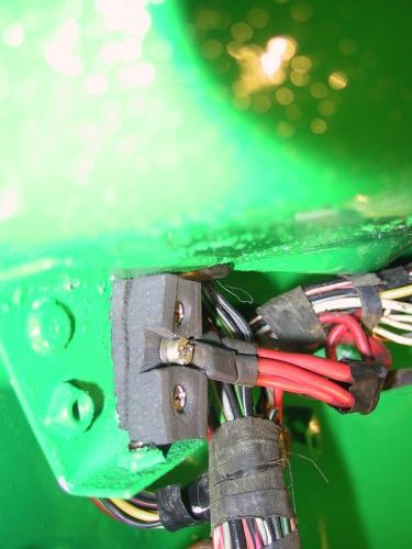

michel richard   I started a separate thread to find help figuring ...   Oct 26 2005, 06:29 PM
michel richard   The picture is not the best, but the parts can be ...   Oct 26 2005, 06:30 PM
michel richard   The bracket that's painted green is the one th...   Oct 26 2005, 06:33 PM
