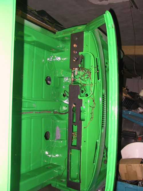

I put the steel sub-dash in, today. I used contact cement to glue the dash material on, then used a very sharp kitchen nife to open holes in the material (I managed to get the knife back in the kitchen before I got into any trouble). Here's how it looks:

michel richard   I put the steel sub-dash in, today. I used contac...   Oct 29 2005, 05:37 PM
michel richard   In the previous shot, you may notice a gray splotc...   Oct 29 2005, 05:40 PM
michel richard   The ignition switch installation is still temporar...   Oct 29 2005, 05:43 PM
