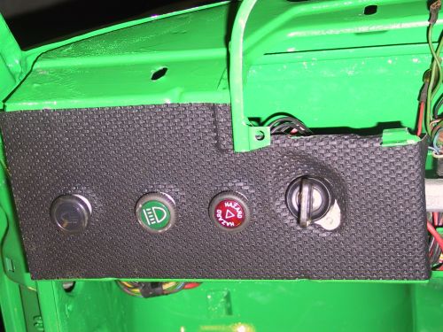

In the previous shot, you may notice a gray splotch in the passenger footwell: I managed to get some work done on the remaining "tub" issues. More on that tomorrow. Also, the switch buttons for the fog lights and the driving ligths are not correct for a 914/6.
I replaced them with what I believe are the correct itmes a few minutes after taking the previous shot. Here's a close-up.

michel richard   I put the steel sub-dash in, today. I used contac...   Oct 29 2005, 05:37 PM
michel richard   In the previous shot, you may notice a gray splotc...   Oct 29 2005, 05:40 PM
michel richard   The ignition switch installation is still temporar...   Oct 29 2005, 05:43 PM
