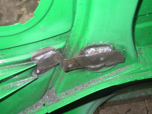

In any event, I got a lot of welding done today, and the "tub" issues are now pretty much taken care of. I welded rear swaybar mounts:
