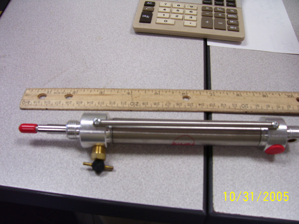

I still like the idea of an air cylinder.....I have a couple of these just laying around in different throws....aluminum and stainless....an accumilator (from a CIS equipped car???) could be used to "store" vac???
