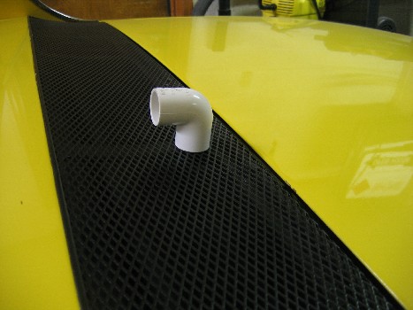

At the DE today at Firebird Raceway, there was one very quick 2.0L 914.
I met and talked with the owner John Seymour for awhile. One of the innovations he came up with really looks interesting. Instead of the stock air filter box. he looked for a way to get cooler air into the motor. Study the photo (I have more if you want me to post). He ran a PVC pipe from the TPS to hoses that go down to the J tubes. From there they are connected to the air ducts in the longs and finally, he is pulling air from the opening in front of the windshield. He claims it works like a charm. I don't doubt him, as he is running D-jet and was as quick or quicker than the 2.0L cars that had been converted to carbs.

Hammy   I'm a bit confused as to how the air goes to t...   Nov 14 2005, 12:49 AM
Brando   Now if he put a little scoop over the front air ve...   Nov 14 2005, 12:52 AM

jkeyzer   Does that actually work or is all the piping a res...   Nov 14 2005, 02:33 AM
Andyrew   I agree, probably negligable. You want cold air? ...   Nov 14 2005, 02:47 AM
gregrobbins   Does it work? He says he is running a stock fi 2.0...   Nov 14 2005, 08:38 AM
Jake Raby   Cooler air makes more power, no matter the engine-...   Nov 14 2005, 09:34 AM
dmenche914   No provision for an air filter is seen. In my opi...   Nov 14 2005, 10:14 AM
URY914   There is no doubt that cooler air can make more po...   Nov 14 2005, 10:28 AM
Jake Raby   It doesn't look like it has very much volume t...   Nov 14 2005, 11:27 AM
Racer Chris   The fresh air box ahead of the windshield sees hig...   Nov 14 2005, 11:49 AM
Rand     Nov 14 2005, 04:40 PM
jsteele22   Most of the time an intercooler is used in a turbo...   Nov 14 2005, 04:42 PM
scotty b   flow rate could easily be increased with two of th...   Nov 14 2005, 06:28 PM
