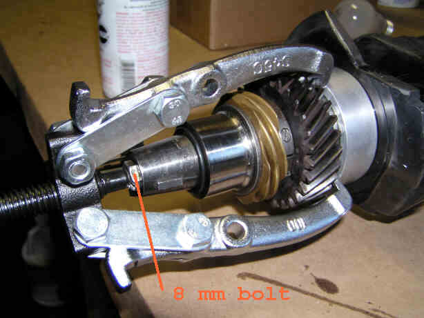

Time to get this thing done so, here's how I pulled the gears on the crank and replaced the #3 main bearing.
First I drilled a countersink into the top of an 8 mm bolt to protect the threads in the nose of the crank thtat secures the fan hub.

I threaded that bolt into the nose of the crank then started applying tension with a puller. Oh ya, you need heat to expand the gears.
