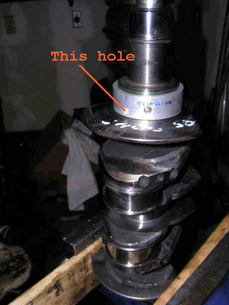

Clean and lube up the journal and put the bearing on. The hole for the dowel goes toward the flywheel end of the crank.
