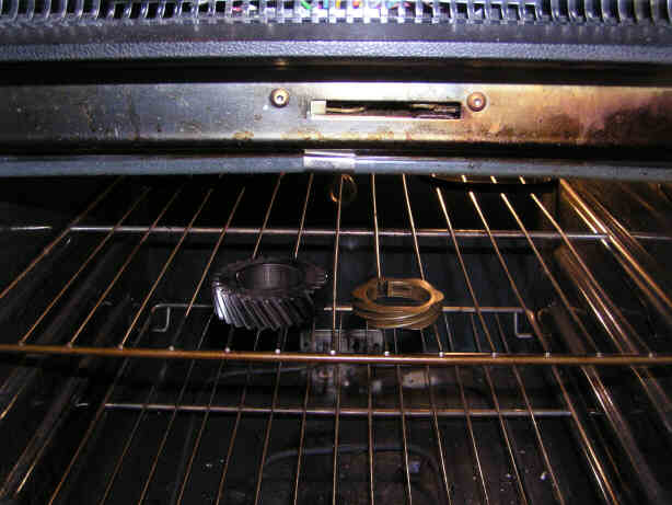

Time to get this thing done so, here's how I pulled the gears on the crank and replaced the #3 main bearing.
First I drilled a countersink into the top of an 8 mm bolt to protect the threads in the nose of the crank thtat secures the fan hub.

Heat up the gears to expand them. I got away with this because my wife was at work today.

Headrage   I used a toaster oven for my gears. Once they are...   Nov 23 2005, 01:48 PM
DNHunt   Drop the gear on, line up the slot with the Woodru...   Nov 23 2005, 01:48 PM
