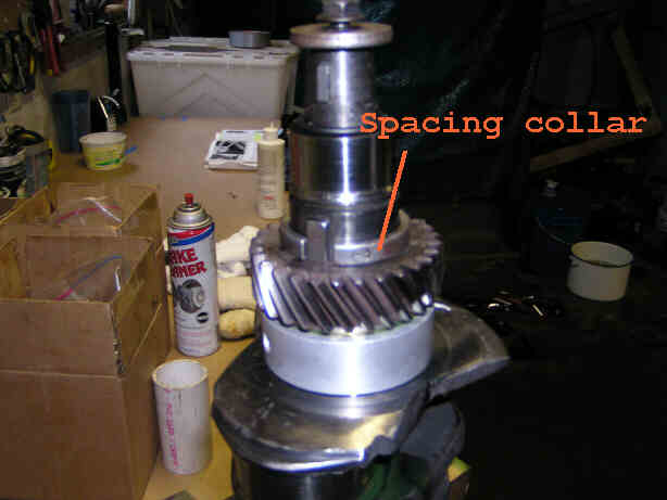

Time to get this thing done so, here's how I pulled the gears on the crank and replaced the #3 main bearing.
First I drilled a countersink into the top of an 8 mm bolt to protect the threads in the nose of the crank thtat secures the fan hub.

Next comes a spacer with the VW logo.
