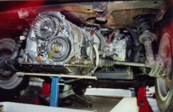

(IMG:http://www.914world.com/bbs2/uploads_offsite/www.sakercars.com.au-3518-1269662543.1.JPG)
That's a Suby AWD trans converted to RWD with 2 parts <!-- emo&:beer2: -->(IMG:http://www.914world.com/bbs2/html/emoticons/beerchug.gif)<!-- endemo -->
Convertor sleeve: AUD$120.00
Blanking plate: AUD$110.00
If bought together, total price AUD$210.00
Looks like a side shift linkage could be tweaked to work.
I just bought a 2005 (EJ25) engine and trans (2000 miles) for the 914 - let the fun begin.
I just sent an e-mail to sakercars to check on parts availability.
Steve. <!-- emo&:beer3: -->(IMG:http://www.914world.com/bbs2/html/emoticons/beer3.gif)<!-- endemo -->
