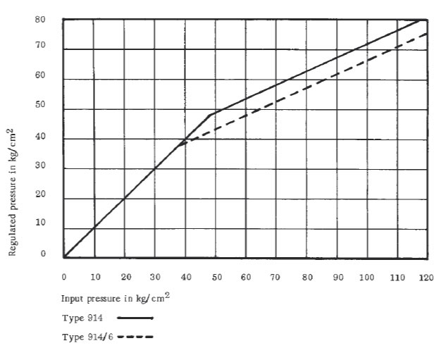

Ok, I know this has probably been discussed in many threads before. But, what is the reasoning for replacement of the Prop. valve with the "T" fitting for the rear brakes. Does the prop. valve cause more line pressure to the fronts or the rears when it is operating properly? I want to understand the engineering aspects of this modification.
I will be running "M" calipers with mythical billet hubs in the front and stock 914-4s in the rear.

You mean, this graph Dave? (IMG:http://www.914world.com/bbs2/html/emoticons/biggrin.gif) It was on the next page. I hadn't turned the page. (IMG:http://www.914world.com/bbs2/html/emoticons/pinch.gif)

McMark   The prop valve limits the amount of hydraulic pres...   Dec 1 2005, 08:33 PM
