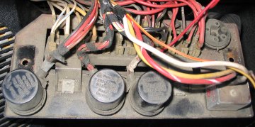

I can find lots of resources that identify which fuse goes with what, but I can't find anything for the relays on the top of the fusebox. I have 3 round ones in a row, then the square one, and an empty round one above that. What do they go to?
Here's a rough diagram, looking from the top of the fusebox as if sitting in the driver's seat:

I'm still wondering about the rest of the relays. I don't know why I bothered with trying to make a diagram (especially since the spacing got all messed up). Here's a picture. What are the different round relays for, especially that empty socket in the upper-right corner?
