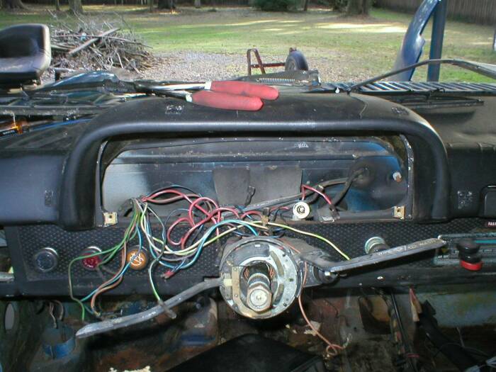

Well, I'm in the process of dismantling one of my parts car and I've decided to document the steps used to remove the dash top.
I began removing the top dash pad by removing the instrument cluster. If you haven't removed the steering wheel and knee pad, do that now. Next, remove the 4 screws that hold the cluster to the dash. Now, just pull the cluster forward, without removing the electrical connections. I have removed the cluster completely from the car because I'm stripping it. You don't have to do this to remove the dash top.

This shows the steering wheel and instrumentation cluster removed. Again, I did this because I'm stipping the car and to be able to better photograph the location of the nuts/bolts.
