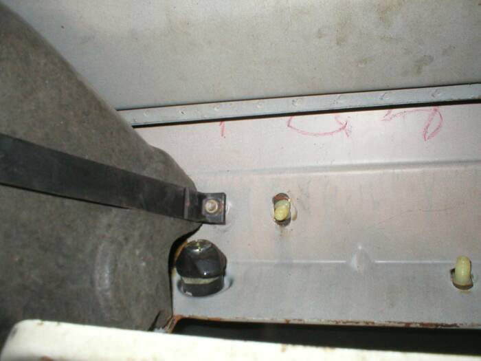

Next I removed the glove box. Begin by removing the small nut, facing down. This holds the metal strap that wraps around the box.

watsonrx13   This shows the next 2 nuts. There is one directly ...   Dec 14 2005, 07:36 PM

watsonrx13   The last 2 nuts can now be removed. Both are direc...   Dec 14 2005, 07:37 PM
watsonrx13   Now, carefully pull the dash top up. There are 9 n...   Dec 14 2005, 07:38 PM
watsonrx13   This shows the plastic bolts on the passenger side...   Dec 14 2005, 07:38 PM
watsonrx13   This shows the bolts around the ash tray.   Dec 14 2005, 07:38 PM
watsonrx13   This shows the bolts on the driver's side.   Dec 14 2005, 07:39 PM
