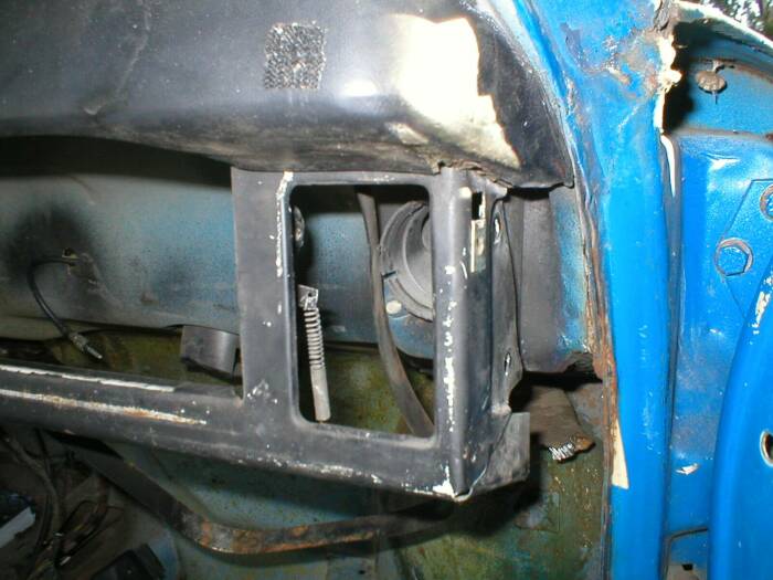

Before removing the glove box, remove the spring, seen here through the vent opening. Finally, move the metal strap out of the way and carefully push the glove box, with its door, towards the front of the car. The box will be removed from underneath the dash.
