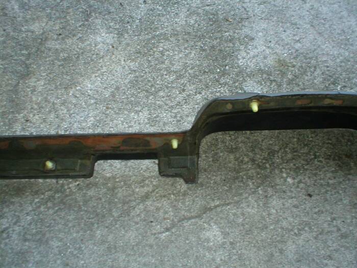

This shows the bolts around the ash tray.

watsonrx13   Now, carefully pull the dash top up. There are 9 n...   Dec 14 2005, 07:38 PM
watsonrx13   This shows the plastic bolts on the passenger side...   Dec 14 2005, 07:38 PM
watsonrx13   This shows the bolts around the ash tray.   Dec 14 2005, 07:38 PM
watsonrx13   This shows the bolts on the driver's side.   Dec 14 2005, 07:39 PM
