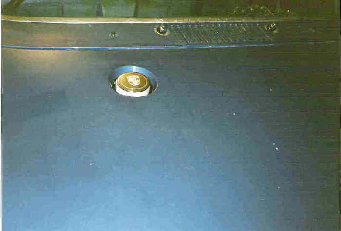

I did both methods, this picture welded ring , the other I did hole saw and hammer and dolly but did a shorter lip about 1/2inch

sixnotfour   I did both methods, this picture welded ring , the...   Dec 15 2005, 12:26 AM
