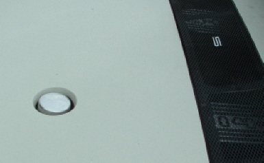

> Metal shapers, How do you roll the edge, of a 3" hole for an exposed gas cap?

I looked at alot of cars at the dismantler but the round gas cap holes are usually 5" diameter to allow you to stick your hand in. The smaller ones like on the early Rabbit have a flange to mount the gas filler.

neo914-6   Metal shapers, How do you roll the edge   Dec 14 2005, 11:52 PM
Bleyseng   thats stamped and it takes a large metal press to ...   Dec 14 2005, 11:55 PM
Andyrew   Have you tried with a hammer and dolley to make th...   Dec 14 2005, 11:59 PM
rick 918-S   Make an inside and out side die set out of 3/8" st...   Dec 15 2005, 12:10 AM
goose2   make a sheet metal ring the same dia as the hole, ...   Dec 15 2005, 12:11 AM
sixnotfour   I did both methods, this picture welded ring , the...   Dec 15 2005, 12:26 AM
sixnotfour   other   Dec 15 2005, 12:44 AM
Andyrew   rear?? Whats that go to? Oil?   Dec 15 2005, 12:49 AM
sixnotfour   peterson oil tank,different ht...   Dec 15 2005, 12:52 AM
Travis Neff   I am with Rick, a belling tool is ticket. If you ...   Dec 15 2005, 01:15 AM
