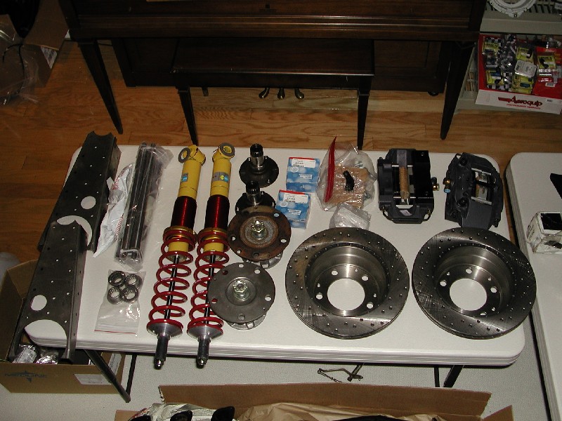

Qarl   Gathered the rear suspension stuff...   Aug 24 2003, 06:24 PM
Qarl   And the front...   Aug 24 2003, 06:25 PM
Qarl   started stripping the rear trailing arms...   Aug 24 2003, 06:26 PM
Aaron Cox   bilsteins on the front? why not koni's?   Aug 24 2003, 06:28 PM
Qarl   Blisteins all round to go with these...   Aug 24 2003, 06:40 PM
ChrisReale   Pretty sweet karl. What Sway Bar are you gunna use...   Aug 24 2003, 07:03 PM
Qarl   Smart Racing bar. I locate the through-holes for ...   Aug 24 2003, 07:05 PM
URY914   So what's up with boxing the trailing arms? Ar...   Aug 24 2003, 07:10 PM
ChrisReale   Cool, what size?   Aug 24 2003, 07:11 PM
Aaron Cox   cool, bilstein strut assembly's.... :woohoo: -...   Aug 24 2003, 07:18 PM
Qarl   I have the arm reinforcing kits. Still debating o...   Aug 24 2003, 07:30 PM

Brad Roberts   Timo, We purchase that kit from Clewitt engineer...   Aug 25 2003, 09:12 AM
fiid   I second what Brad says about doing it right. Doi...   Aug 25 2003, 09:57 AM
Qarl   I've got a set of period NOS Cibie Z-beam head...   Aug 25 2003, 12:15 PM

Qarl   Early 911 5-bolt hubs Early 911 stub axles 4-bolt...   Sep 3 2003, 08:30 AM
maf914   Karl, Thanks. I wonder how hard it is to find Spo...   Sep 3 2003, 11:01 AM
Qarl   There are a couple of different variations on the ...   Sep 3 2003, 11:26 AM
Brad Roberts   You can run this setup with the regular 901/915 c...   Sep 3 2003, 12:14 PM
boxstr   Karl I was under the impression that the dust cove...   Sep 3 2003, 07:48 PM
echocanyons   I have the same rear setup why are you using rear ...   Sep 3 2003, 09:29 PM
Qarl   The early 911 (69-71) hubs use the same wheel bear...   Sep 3 2003, 09:34 PM
Qarl   Umm... Craig... you're probably right. I didn...   Sep 3 2003, 09:42 PM
