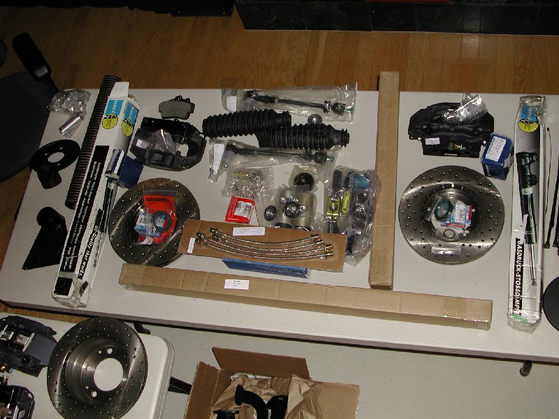

Qarl   Gathered the rear suspension stuff...   Aug 24 2003, 06:24 PM
Qarl   And the front...   Aug 24 2003, 06:25 PM

Aaron Cox   bilsteins on the front? why not koni's?   Aug 24 2003, 06:28 PM
Qarl   Blisteins all round to go with these...   Aug 24 2003, 06:40 PM

URY914   So what's up with boxing the trailing arms? Ar...   Aug 24 2003, 07:10 PM
ChrisReale   Cool, what size?   Aug 24 2003, 07:11 PM
Aaron Cox   cool, bilstein strut assembly's.... :woohoo: -...   Aug 24 2003, 07:18 PM
Qarl   I have the arm reinforcing kits. Still debating o...   Aug 24 2003, 07:30 PM
