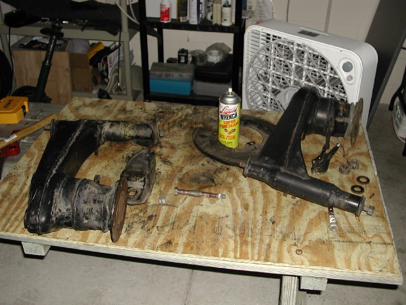

started stripping the rear trailing arms...

Qarl   started stripping the rear trailing arms...   Aug 24 2003, 06:26 PM

URY914   So what's up with boxing the trailing arms? Ar...   Aug 24 2003, 07:10 PM

Qarl   I have the arm reinforcing kits. Still debating o...   Aug 24 2003, 07:30 PM
