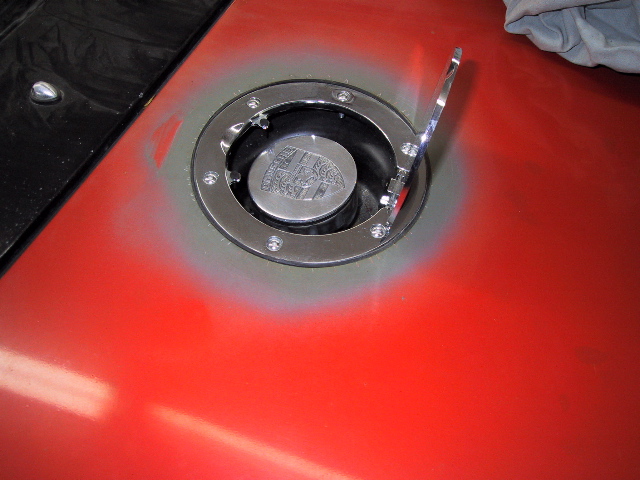

This is how mine looks with the door open.

iamchappy   I topped off the stock cap with a wheel centercap.   Dec 16 2005, 04:06 PM
